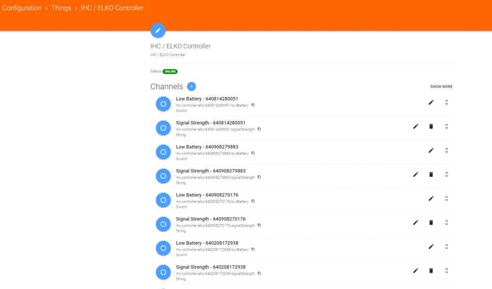

Hi Pauli.. I´m just about to test the latest IHC binding, but I ran into a problem.. It seems like the binding use the default port (443) for connection. I have change the port on my IHC controller. And now I get connection refused. I fixed using the same settings as in binding 1.12.. but perhaps you should maka an option in the things settings for the port to use!
@Pauli Anttila
Hmm. I´m not quite sure if this is correct.

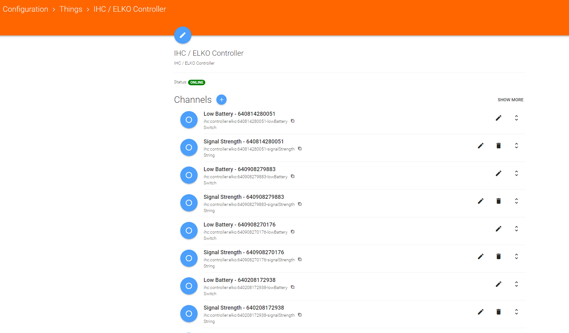

I got the new binding up running on a clean install 2.4 (M6 snapshot release). Binding installed fine, and after the change in the port, it connected fine to the IHC controller. I put the createChannelsAutomatically=true and it found lots of channels, ofcouse..
But the first 72 channels looks like this:
That make me wonder, cause I one have 3 wireles battery devices and 7 wireless dimmer devices. But it looks like it found 36 devices??

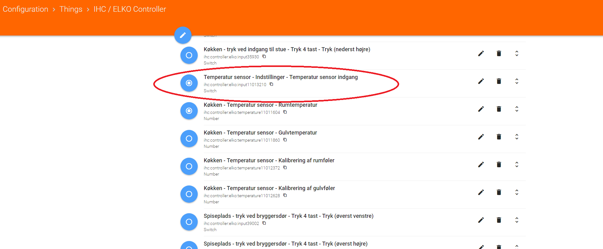

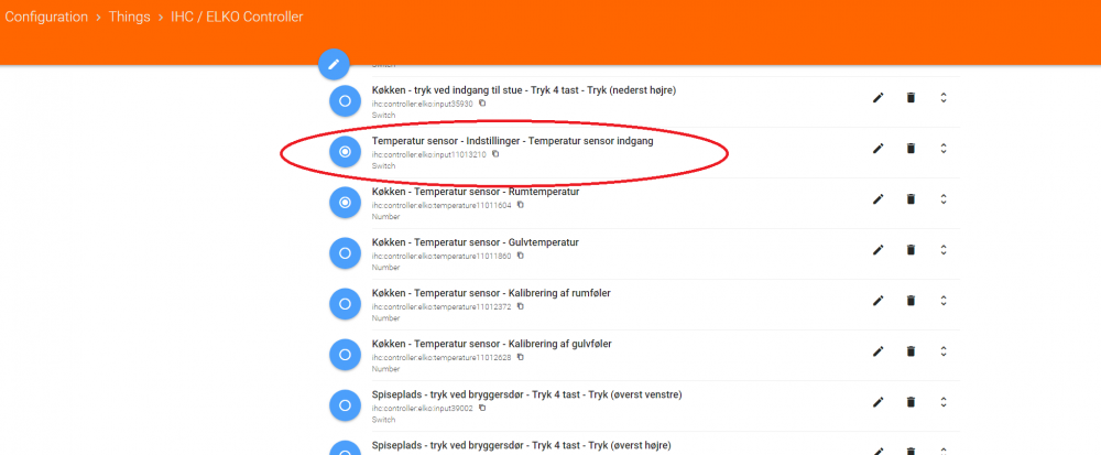

Another problem is the temperature sensor.
From what I can understand you read the resources ID of the product and create channels from them. And most of the temperatur sensor seems to be correct. But I have one channel which I cant figure where comes from.
1277616037_nyihcbindingtemperaturindgangl.thumb.png.b75442c476c295bc298bba22b4c7fa46.png
This one, with the red circle. When I use Visual or an alternative IHC viewer, which also tells me the recourse ID, I cant find it anywhere.
For some reason it does now have a name of the location (i would have suspected Køkken, like the channels underneeth). But this resource ID is not part of the temperature sensor in the Køkken location. Infact I cant find it anywhere.. So where does this one come from?

@Kandersen
Quote
Your controller is reporting 38 wireless devices.

Quote

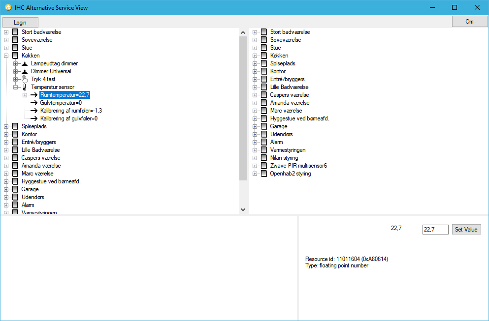

Those are temperature sensor's alarm inputs. I don't know the reason why the location information isn't correct (it's not correct in my environment either). In fact, I haven't recognised those alarm inputs earlier (never looked so deeply), but I will check if those could be improved.

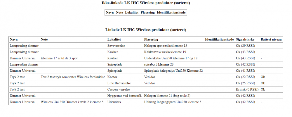

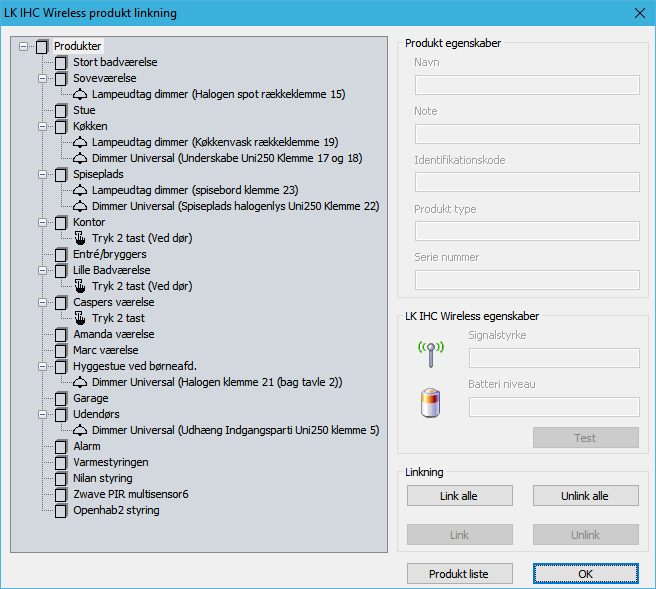

But how is that possible, when I only got 10 wireles devices?? And only 3 battery devices?? It has to come from somewhere..
This is my Visual program, (vis):
mejsevænget 14_11_2018 inverter PIR.vis
Here is a screendump of my wireless products:
Hmm, I just saw that now using the real ServiceViewer.. For some reason it doesn´t show the Alarm, and I had forgotten all about it..
This is how it looks like in Dingus´s Alternative IHC viewer:
Quote
Well, Binding is using controller AirlinkManagementService to ask detected devices and as you can see from the log, result contains 38 devices. What is the outcome if you press "Product liste" button in "LK IHC Wireless product linking" window?
11 minutter siden, Pauli Anttila skrev:
@Kandersen Could you send serial numbers of those 10 devices (which device is which)?
Sure:
This is take from the Visual option of creating documentation for the installation.
Lokalitet Soveværelse
Placering Halogen spot rækkeklemme 15
Komponent Lampeudtag dimmer ø80
Identifikationskode --
Serie nummer _0x640816240287
Lysgruppe IHC 3
Lokalitet Køkken
Placering Køkkenvask rækkeklemme 19
Serie nummer _0x640816240122
Lysgruppe IHC 4
Lokalitet Køkken
Placering Underskabe Uni250 Klemme 17 og 18
Komponent Dimmer Universal UNI250 (1-modul)
Serie nummer _0x640a07237810
Lysgruppe IHC 4
Lokalitet Spiseplads
Placering spisebord klemme 23
Serie nummer _0x640816240124
Lysgruppe IHC 4
Placering Spiseplads halogenlys Uni250 Klemme 22
Serie nummer _0x640a07237823
Lysgruppe IHC 4
Lokalitet Kontor
Placering Ved dør
Komponent Tryk 2 tast (wireless pushbutton)
Serie nummer _0x640e15123673
Lysgruppe --
Lokalitet Lille Badværelse
Placering Ved dør
Serie nummer _0x640e15123789
Lysgruppe --
Lokalitet Caspers værelse
Placering --
Serie nummer _0x640e15123809
Lysgruppe --
Lokalitet Hyggestue ved børneafd.
Placering Halogen klemme 21 (bag tavle 2)
Serie nummer _0x640a07237758
Lysgruppe IHC 1
Lokalitet Udendørs
Placering Udhæng Indgangsparti Uni250 klemme 5
Serie nummer _0x640a07237960
Lysgruppe IHC 5

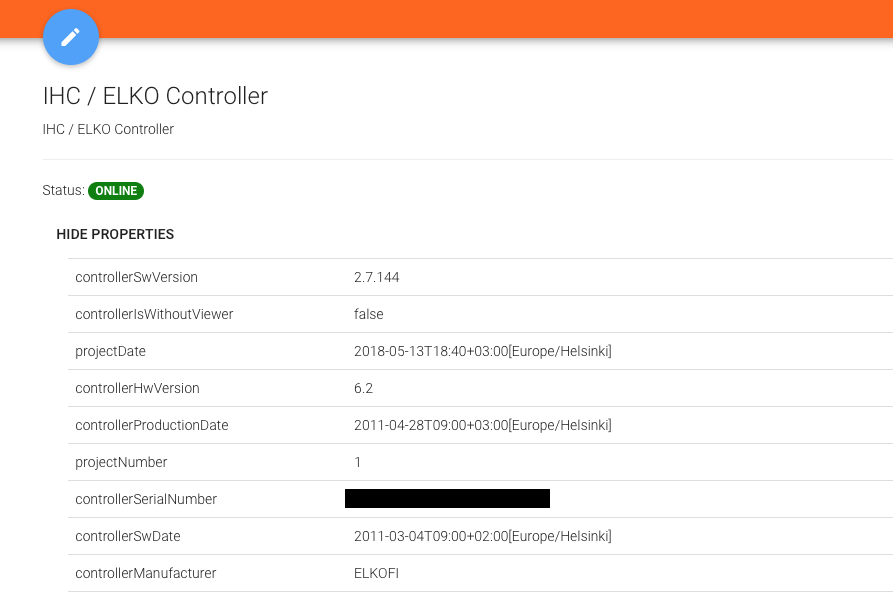

@Kandersen Could you try following version https://www.dropbox.com/s/bn3k50w8or10rro/org.openhab.binding.ihc_2.4.0.201811282019.jar?dl=0
  • RF channels are generated from project file rather than AirlinkManagementService
  • RF device battery and signal strength channels have better description
  • Temperature sensor alarm input description should be correct
  • Controller SW and HW version channels are moved to thing properties
  • Added more thing properties
Alot better. I do get a few channels where the name doesnt seem right (like its missing room name). But I need to check up with Visual on this one. At least the number of RF devices are down to a real figure.
Yes, alot better as well.
Is it!
Yup, working fine here as well.. Btw why dont you use the latest firmware for HW 6.2?

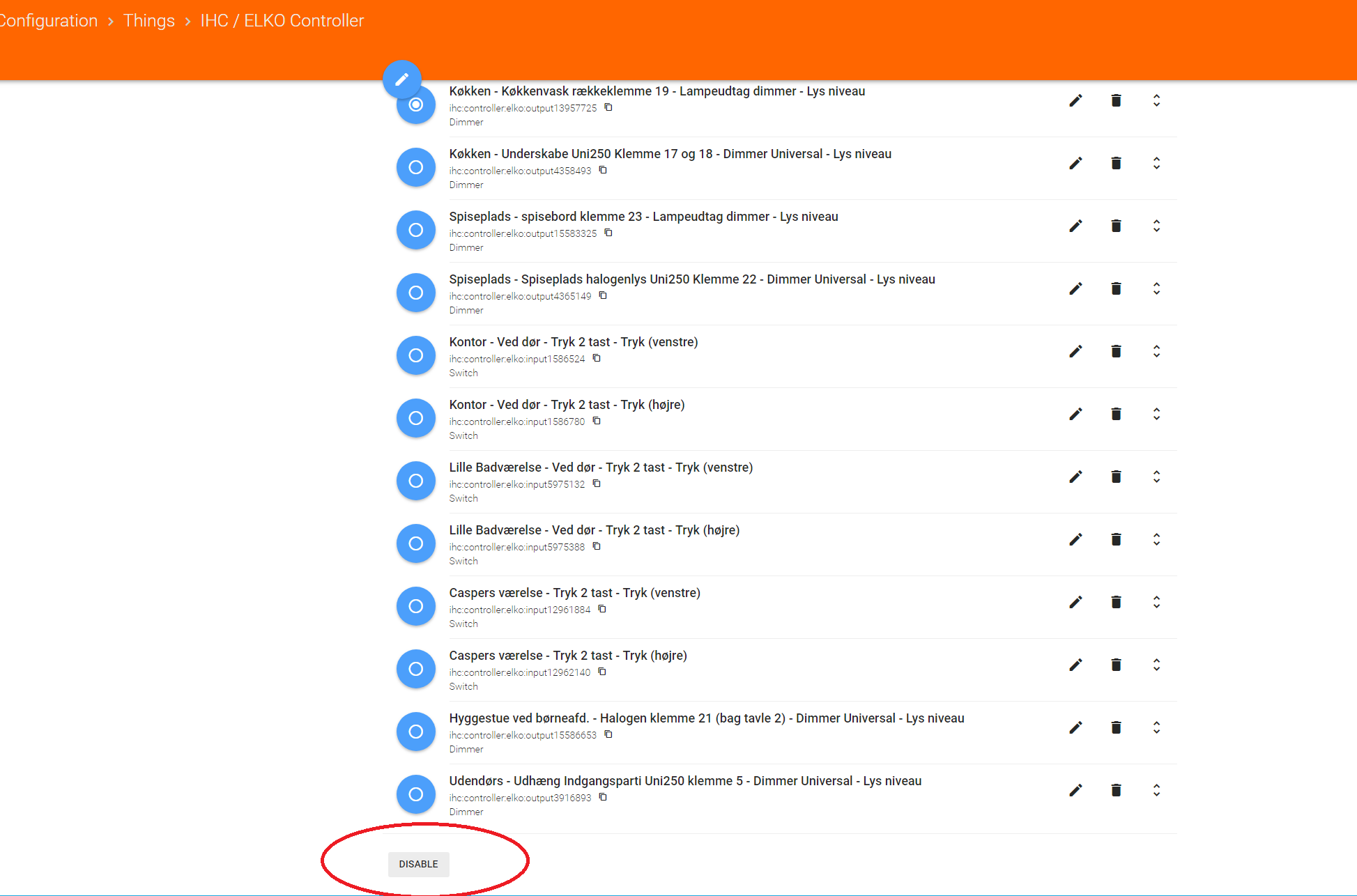

One small request..
Is it possible to move the enable/disable button to the top insted of the bottom. Having hundreds of channels, it takes a while to scroll all the way down :D
3 timer siden, Pauli Anttila skrev:
I haven't had a single problem with 2.7.144, so I just don't want to break it :)
Fair argument :)
Enable/disable button?
This one:
(I dont know if it´s the binding or because I´m running openhab 2.4 M6 (milestone build).
