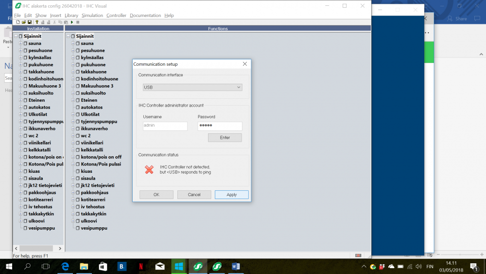

Pertti Korhonen Besvaret May 3, 2018 Forfatter Rapporter Share Besvaret May 3, 2018 Hello Lars, I have now updated my IHC Visual to version 2.8.4. I succeeded in reading the old config (.vis) files but when trying to connect with my new HW6.2 controllers through USB I get this error message (attached). I cannot log into the controller. This is the first time this controller is powered up.How to overcome this login problem? (I have tried with two options: Username = "admin", no password and then also "admin" as the password as well. Neither option works. Citér Link til kommentar Del på andre sites More sharing options...
Pertti Korhonen Besvaret May 3, 2018 Forfatter Rapporter Share Besvaret May 3, 2018 53 minutes ago, Pertti Korhonen said: Hello Lars, I have now updated my IHC Visual to version 2.8.4. I succeeded in reading the old config (.vis) files but when trying to connect with my new HW6.2 controllers through USB I get this error message (attached). I cannot log into the controller. This is the first time this controller is powered up.How to overcome this login problem? (I have tried with two options: Username = "admin", no password and then also "admin" as the password as well. Neither option works. Hello Lars, I actually succeeded to get the connection now! I executed the IHC Firmware loader and updated the FW on both controllers. Now the IHC Visual connects ok and I was even able to upload the old configuration files to the new HW62. controllers! Thank you very much for your help - I think I am able to continue with the project now! Mikkel Skovgaard 1 Citér Link til kommentar Del på andre sites More sharing options...
Lars Jacobsen Besvaret May 3, 2018 Rapporter Share Besvaret May 3, 2018 Yes it can be quite a strugle to get the right combination of firmware in the controller, Visual version on the PC and finally the coherrent JAVA with settings. Citér Link til kommentar Del på andre sites More sharing options...
