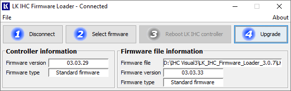

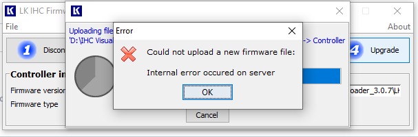

Infernoken Skrevet September 4, 2023 Rapporter Share Skrevet September 4, 2023 The title says it all... I have a brand new IHC Visual 3 controller that I just pulled from the package. (Bought this some time ago, but finally decided it's time to upgrade my Visual 2 HW6.1 controller. I'm trying to update the firmware to the latest 03.03.33 version, but I'm getting "Failed - Internal error occured on server" Any help? Tools and FW come from the belgium site, as I need english: https://www.se.com/be/nl/faqs/FAQ000123465/ EDIT: NEVERMIND! Using the latest SW from the LK website I was able to update to 03.03.44 Found it here: https://www.lk.dk/mitlk/download-ihc-software/ihc-controller-visual-3/ It even still works with my english IHC Visual, so all is well... Other question: I just found the IHC Visual controllers are now really End Of Life ??? So big problem if I still have a component failing in my system???? Citér Link til kommentar Del på andre sites More sharing options...

Infernoken
Any help?
EDIT: NEVERMIND!
