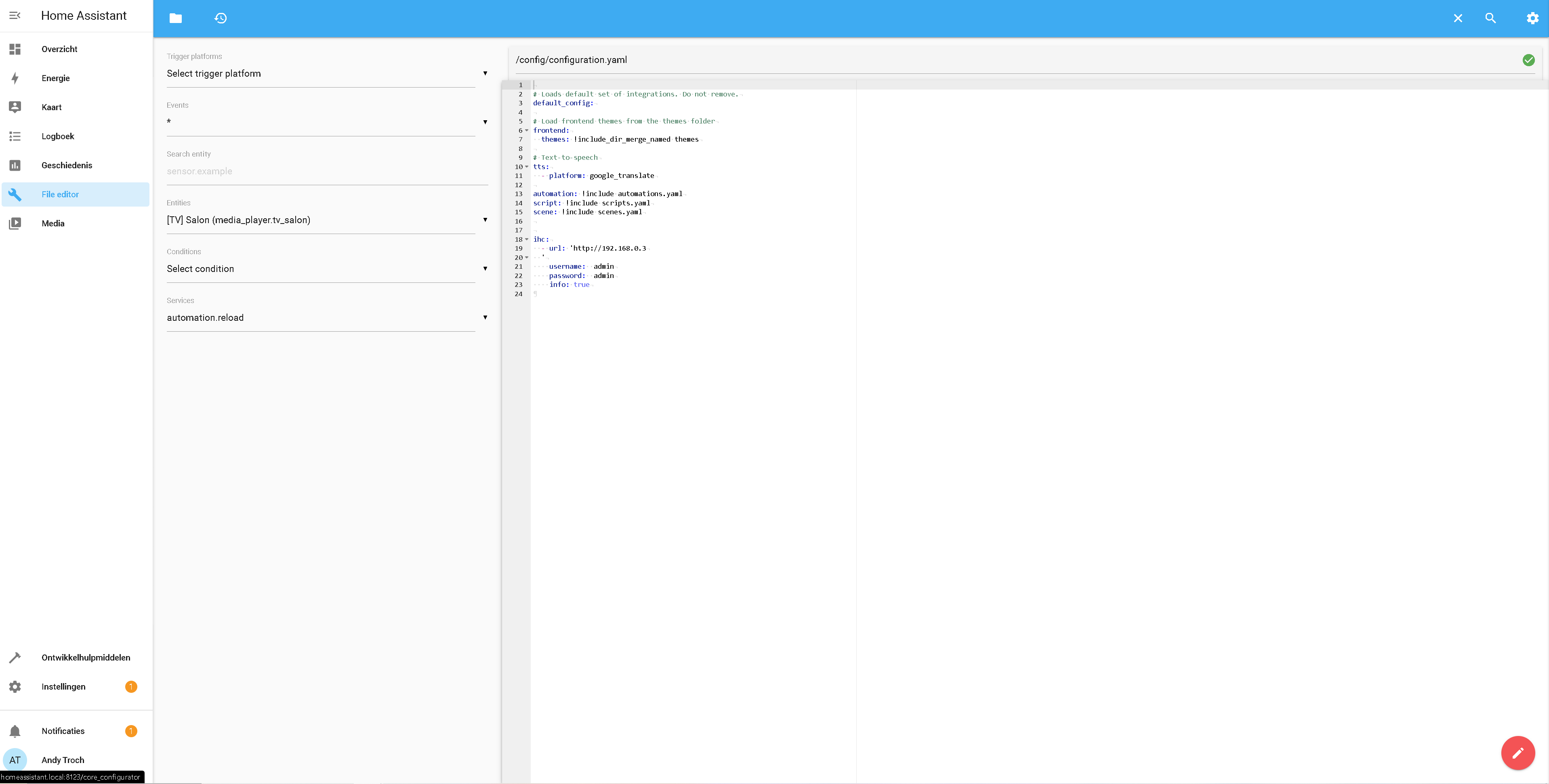

However after some trail and error, i (presume atleast) that settings are done correctly in both IHC & HASS system but still there is no communication between them.
Following "code" has been entered in the file editor in HASS :
These settings (url,account & password) are working on my local netwerk, so i presume that these are correct ?

Although not a IT expert i did setup Home assistant myself and it was quite easy.
i dont believe you should a  issue running it.
Although your config file seems a bit off.
Try what i did copy paste EXACTLY how documentation shows. No spaces or other stuff.
Remember to correct IP adress.username and password.
Like this
  - url: 'http://192.168.1.3'
    username: YOUR_USERNAME
    password: YOUR_PASSWORD
